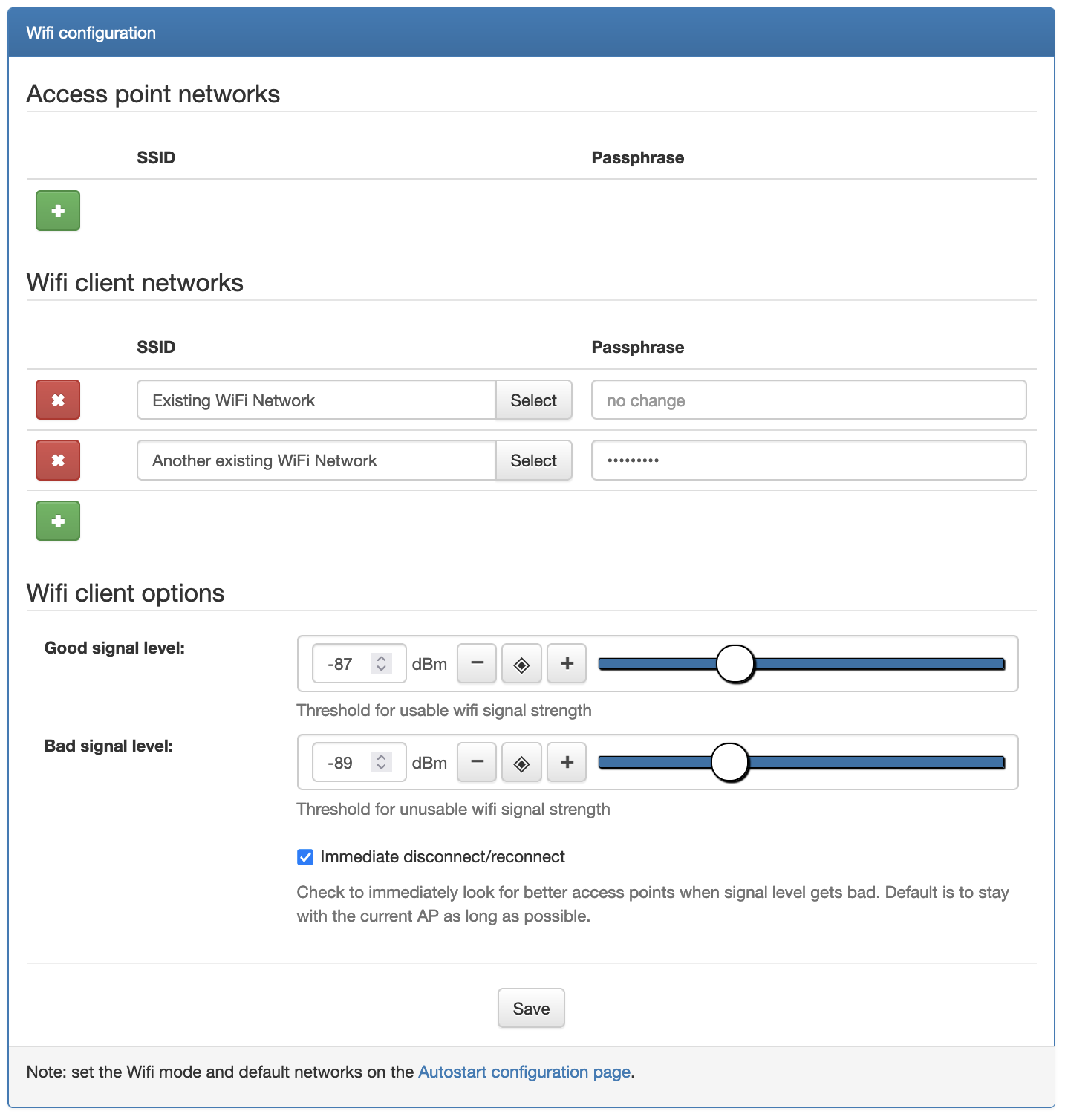

First you need to configure the SSID and passphrase for the known Wifi networks you would like to connect the module to in Config → Wifi:
(you can enter multiple Wifi networks)
