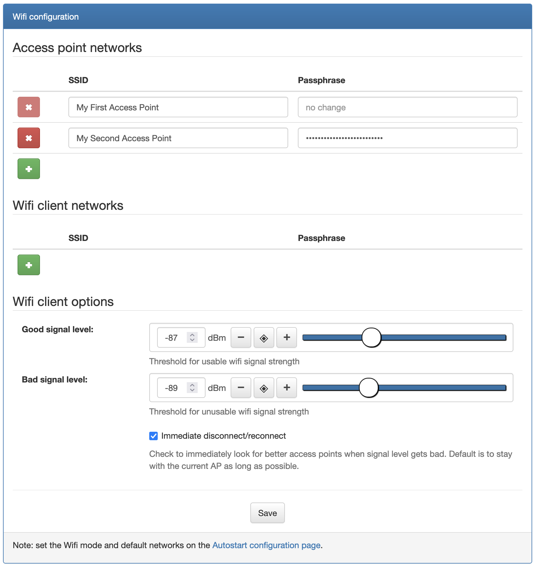

First you need to configure the SSID and passphrase for the Wifi Access point networks you would like to create in Config → Wifi:
(you can enter multiple Wifi Access point networks, however only one will be active at a time)

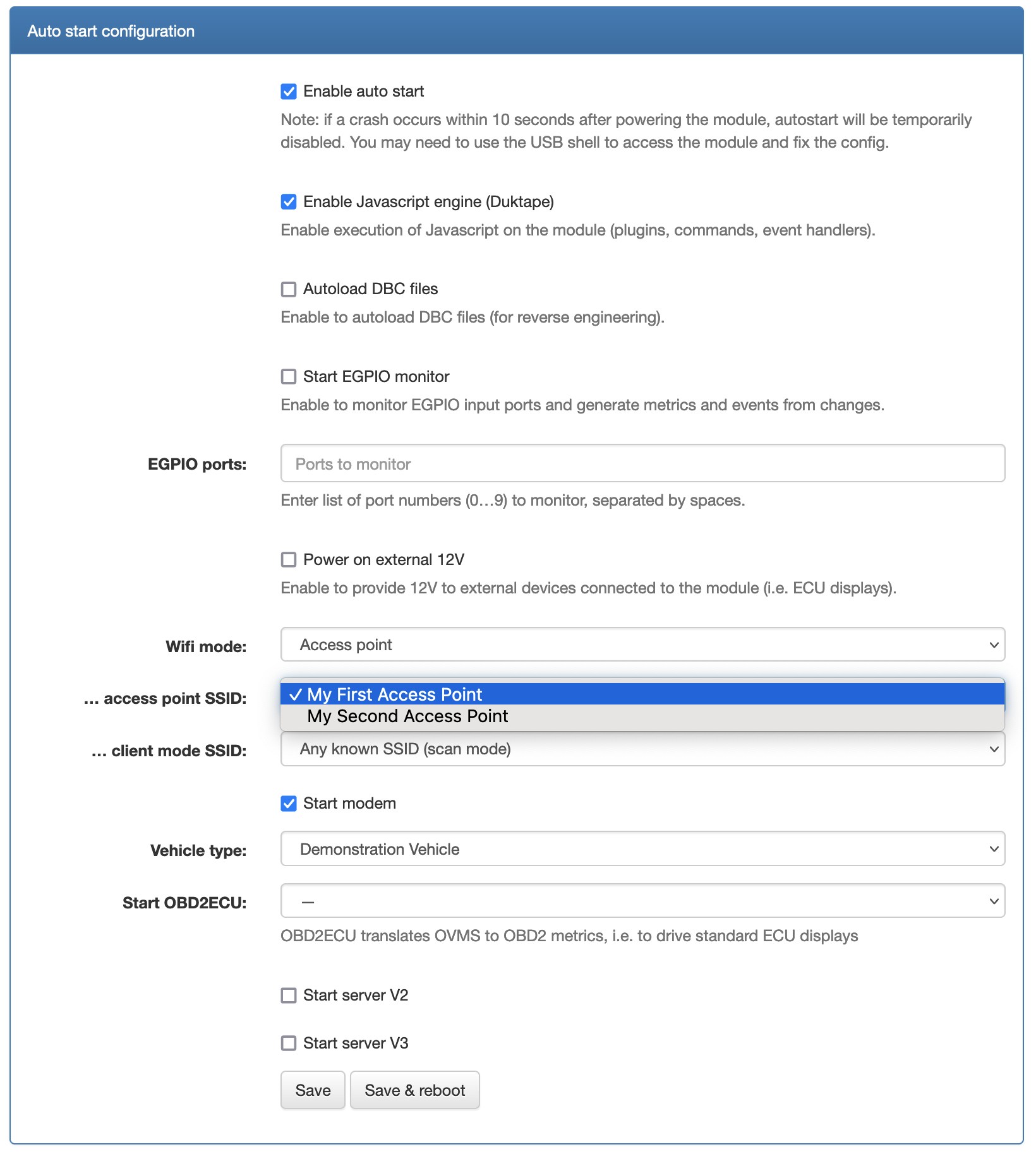

Then you enable the access point mode by choosing a Wifi mode of either “Access point mode” or
“Access point + Client” (preferred) in Config → Autostart, field Wifi mode:
Finally you need to choose which one of these Wifi Access point networks will be active (even if you only defined
one in the first step) - in Config → Autostart,
field ... access point SSID:
