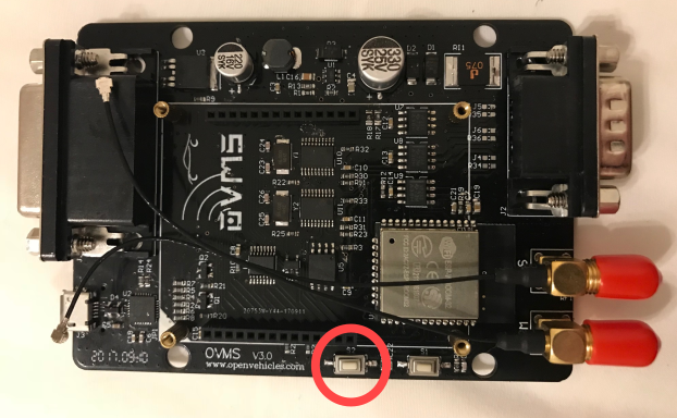

Method 3: Switch S2
You can also open the module case, remove any SD card (important!), power on the module, wait 10 seconds, then push and hold switch “S2” for 10 seconds. “S2” is located here:
