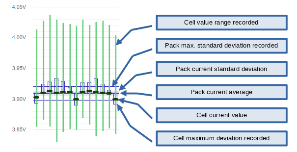

Chart Usage
Voltage and temperature sensors normally differ in number, as voltages are measured for each cell bundle (cells connected in parallel), while temperatures only are measured for a cell module (multiple cell bundles connected in series). Accordingly the monitor is divided into a voltage and a temperature chart.
Click on the chart series names below the charts to show/hide the respective series or group of metrics in that chart.
The charts can be zoomed and pinched using the mouse or dual touch finger
gestures as usual. When zoomed, a zoom reset button is shown in the upper
right corner. To move the zoom window, hold the Ctrl key while clicking,
or tap and move two fingers. Note: horizontal zoom needs an up to date
firmware.
Hovering or clicking on a cell/module chart column will show the actual values (numbers) in a small overlay window.
Values may change while viewing the chart, that’s normal: the chart is a live view of the actual current measurements. That allows to see how the cells respond to sudden high loads.

The table at the bottom shows the overall pack statistics in numbers.
This includes the overall cell/module averages, the maximum and minimum voltage/temperature readings recorded, and the current and recorded maximum standard deviation.
On the cell gradient & max stddev deviation: voltages are very volatile, as current battery cells immediately react to load changes. A high discharge pulse will lead to an instantaneous substantial drop of the cell voltages.
So, depending on how the vehicle’s BMS does the measurements, a full series of voltages may include such a change in between some cells. That would lead to wrong standard deviations and possibly false alerts, so the BMS framework analyses the full voltage series for a gradient, and ignores the series if the configured threshold is exceeded.
The series is also ignored if the standard deviation exceeds the configured “max stddev deviation” value. Combine both thresholds to filter unusable series. The vehicle adaptor provides sensible default thresholds, but you may need to adjust them depending on the age and health of your battery.
