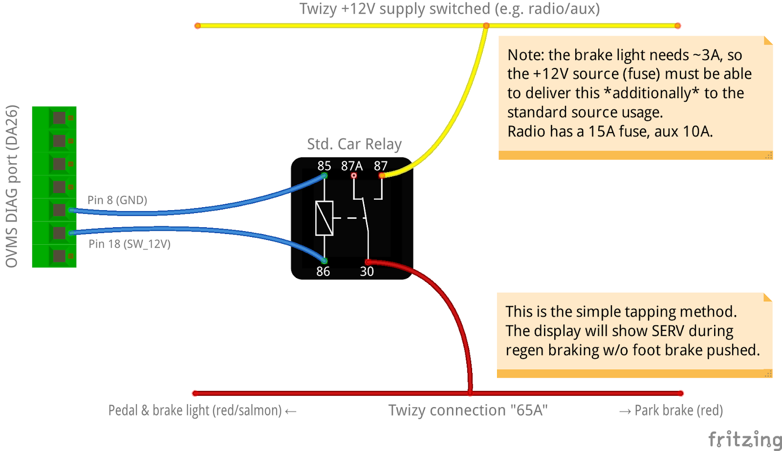

The OVMS generates a secondary regen braking signal itself. That signal is used to control a relay to provide power to the brake light independant of the brake pedal.
Integration is simple and does not require to change the existing connections:
The Twizy UCH/display recognizes the regen brake light activation despite the foot brake being pushed and turns on the SERV indicator. Depending on your preferences you may see this as a problem or as an indicator for the regen braking.
Switching the 65A line does not avoid the SERV indicator (tested). Most probably the brake light is monitored by the current flowing at the fuse box, so the SERV indicator cannot be avoided without changing that system.

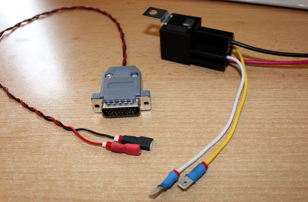

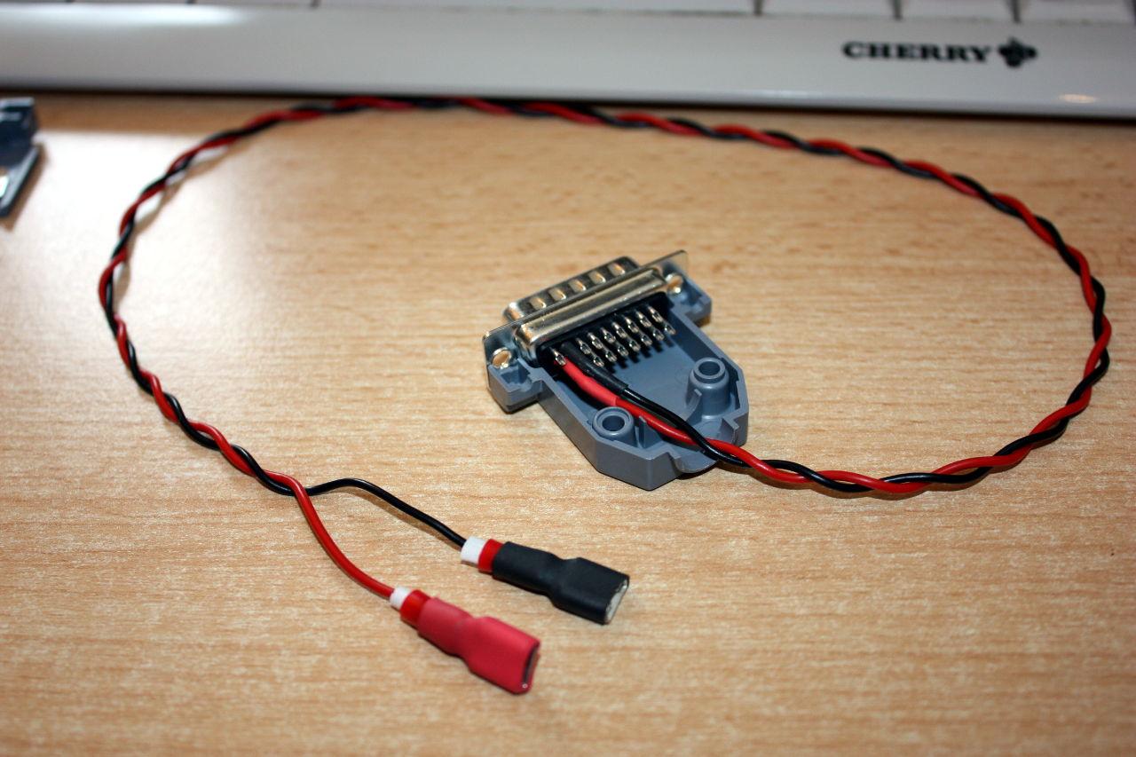

Solder ~ 40 cm two-core wire to the DA26 plug pins 8 (GND) and 18 (+12V switched), use shrink-on tubes to protect the terminals, mount the housing
Crimp 6.3mm sockets to the other ends of the wire, isolate using shrink-on tube, crimp 6.3mm plugs to the relay coil (pins 85 + 86), isolate using shrink-on tube
Extend the relay switch terminals by ~ 30 cm wires, crimp on plugs for the tap connectors

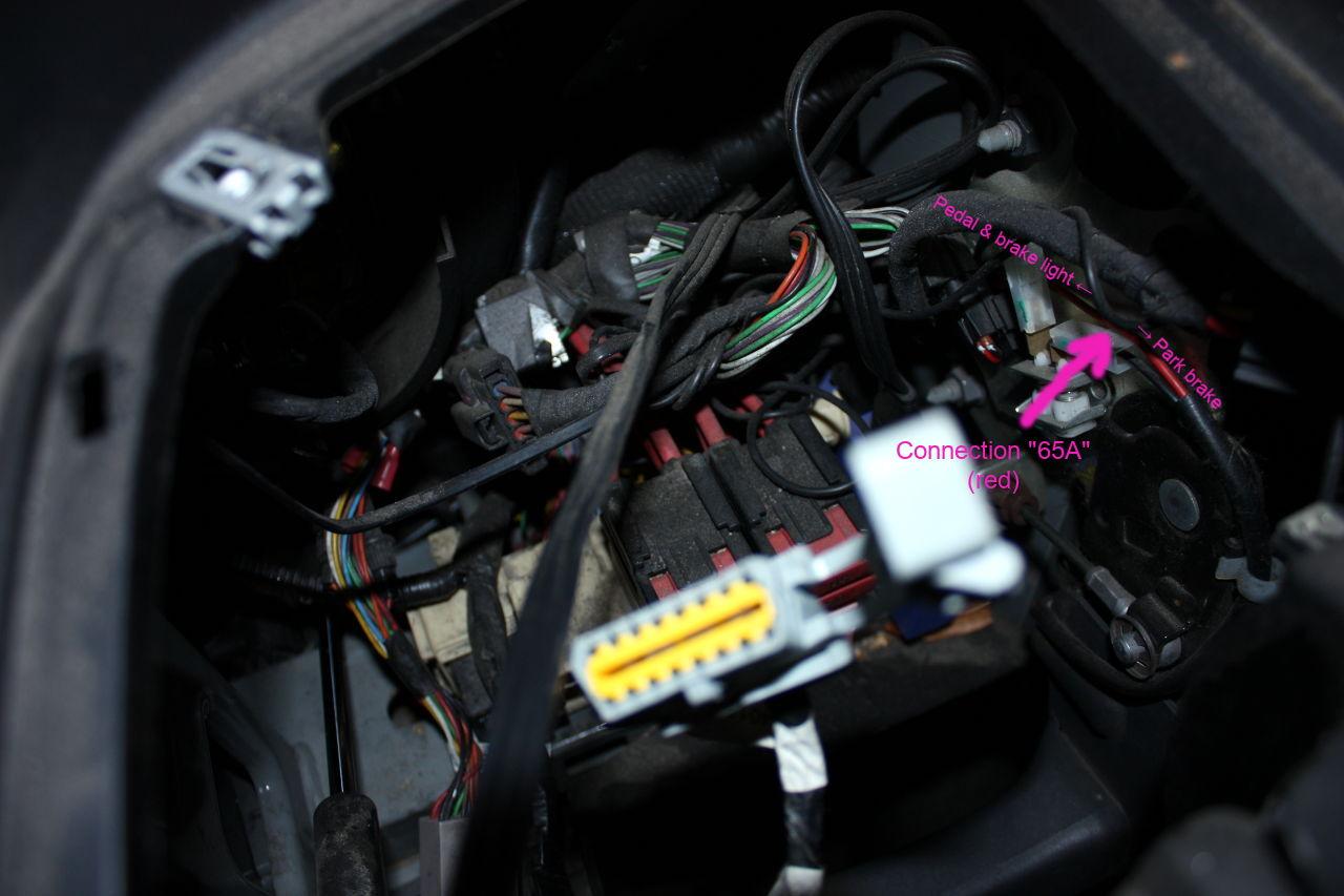

Unmount the Twizy glovebox; locate the red wire on the right above the parking brake:

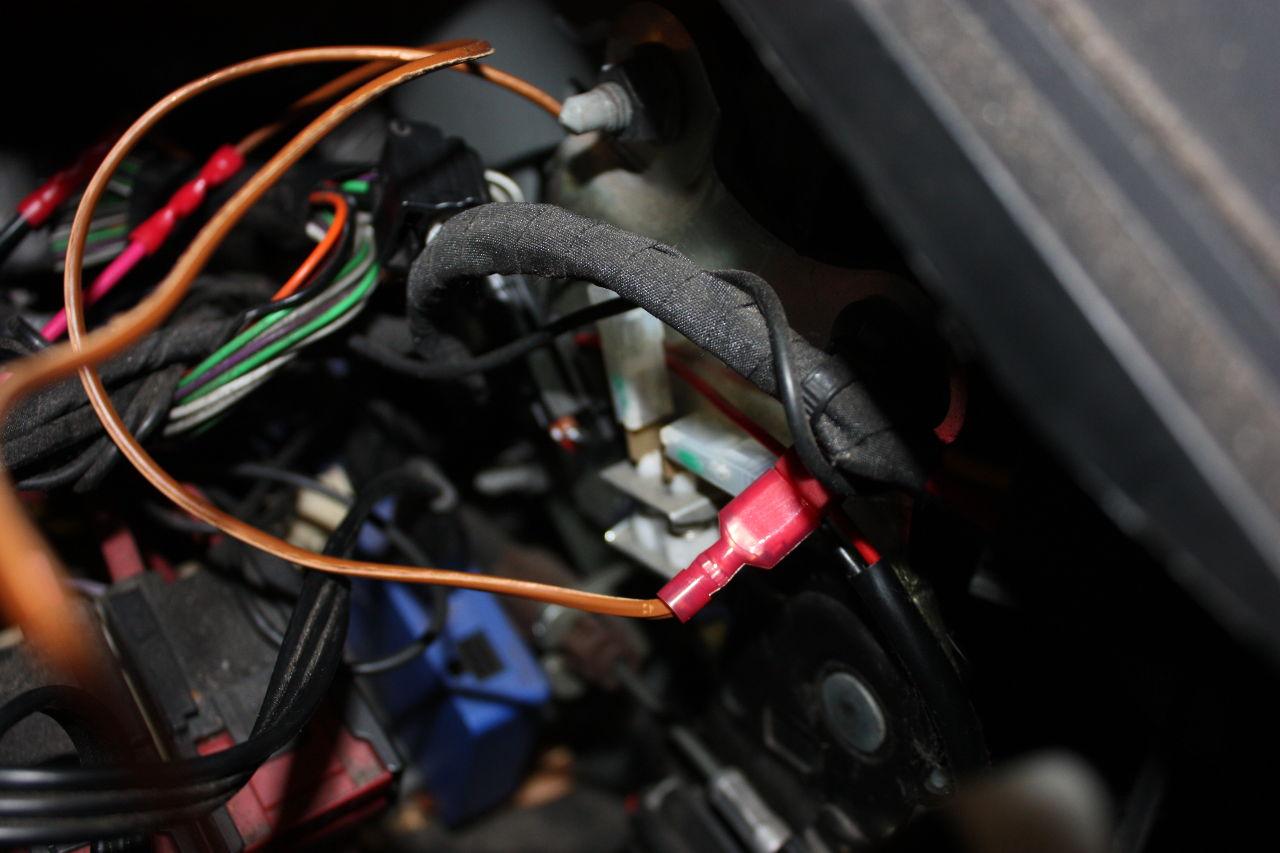

Crimp a tap connector onto the red wire and connect it to the relay (pin 30):
Connect switched +12V likewise to pin 87 of the relay
+12V may be taken from the radio or 12V aux socket to simplify things
