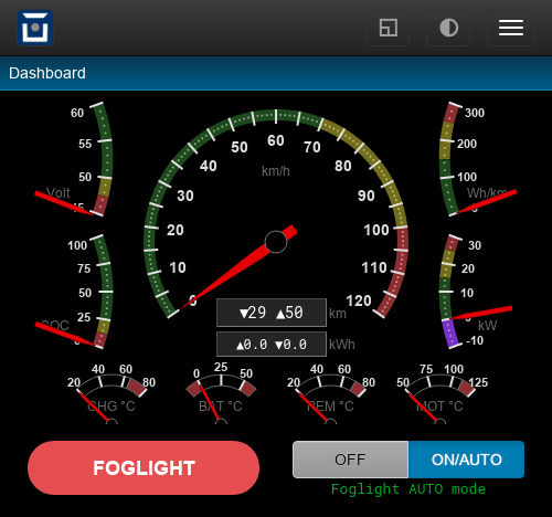

Example: Foglight
../../../_images/foglight.png
This is an example for combining a script module implementing some functional extension with a web plugin to provide a user interface.
The plugin realizes a fog light with automatic speed adaption, i.e. the light will be turned off above a configurable speed and on again when the vehicle slows down again. It also switches off automatically when the vehicle is parked.

  • provide a web UI

Module Plugin

Web Plugin
82// Init & install:
83$('#main').one('load', function(ev) {
84  loadcmd('script eval foglight.info()').then(function(output) {
85    update(JSON.parse(output));
Note
Keep in mind commands should always output some textual response indicating their action and result. If a command does nothing, it should tell the user so. If a command is not intended for shell use, it should still provide some clue about this when called from the shell.
Module Plugin

Web Plugin
foglight.htm (hint: right click, save as)

56      $indicator.removeClass('label-default').addClass('label-danger');
57    else
58      $indicator.removeClass('label-danger').addClass('label-default');
59    // update buttons:
60    $actionset.removeClass('active');
61    $actionset.find('input[value='+foglight.state.on+']').prop('checked', true).parent().addClass('active');
62  }
63
64  // Listen to foglight events:
65  $('#foglight').on('msg:event', function(e, event) {
66    if (event == "usr.foglight.on")
67      update({ state: { port: 1 } });
68    else if (event == "usr.foglight.off")
69      update({ state: { port: 0 } });
70    else if (event == "vehicle.off") {
71      update({ state: { on: 0 } });
72      $('#action-foglight-output').empty();
73    }
74  });
75
76  // Button action:
77  $('#foglight .action-foglight-set input').on('change', function(e) {
78    foglight.state.on = $(this).val();
79    loadcmd('script eval foglight.set('+foglight.state.on+')', '#action-foglight-output');
80  });
81
82  // Init & install:
83  $('#main').one('load', function(ev) {
86      $('#foglight').appendTo('#panel-dashboard .panel-body').show();
87    });
88  });
89
90})();
91</script>
